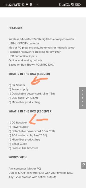

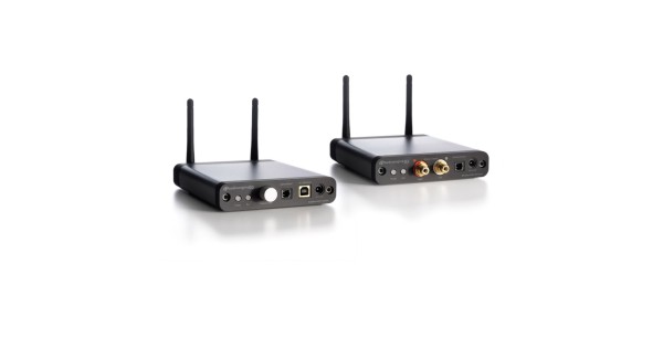

This is a DAC. It converts wireless digital stream to analog output, if I am not wrong. You would need one more device to take that analog audio, digitise it and stream to the speakers.Arjun, I am exploring downsizing from the hifi to an all in one. And I want to play my CDs too. There are other AIOs with optical and coaxial in, but ‘form factor - price - SQ’ wise the RS150 fits best.
I found this through an internet search - not sure if it’s available here. Also, it is over designed (has a DAC as well as USB-SPDIF converter) for my need. Still hoping there’s something out there for this peculiar need and someone here knows!
Hope this is a trustworthy Indian reseller. Shall speak to them tomorrow:
Audioengine D2 Premium 24-Bit Wireless DAC
Advantages of wireless - The D2 wireless system transmits bit-perfect PCM-stereo simultaneously to up to 3 receivers. This PCM stream is routed from/to the various components of the system (optical transmitter/receiver, USB controller and DAC) via the I2S Bus, which maintains data integrity throughoproaudiohome.com
