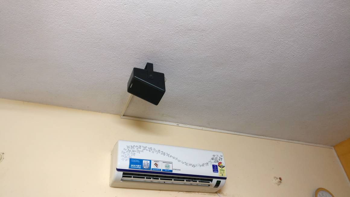

I'm just posting the photos for the benefit of some members. It's a sonodyne sonus 3540 speaker which comes with brackets for mounting it on ceiling /wall with tilt options.
Sent from my ONEPLUS A3003 using Tapatalk

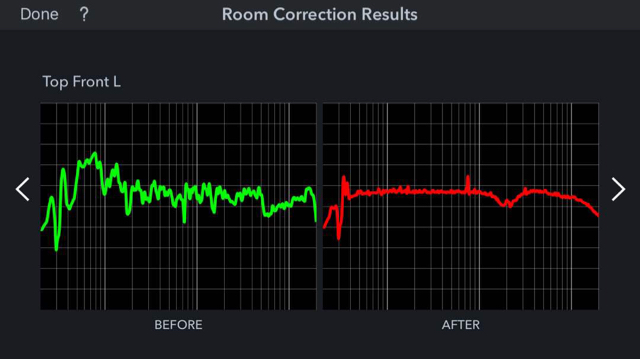

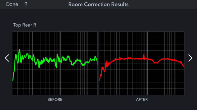

Sharing frequency response from MultEQ app for ceiling speakers.
Thanks.. Not from the Multi EQ app, but from the OSD of the AVR..
Setup (AVR Remote Button) - Speakers - Audyssey Setup - check results - crossover..
These are the lowest response detected by Audyssey after calibration..
