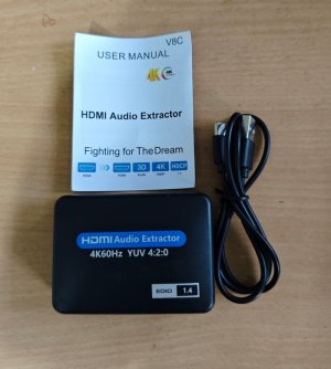

Received the Tobo Audio Extractor yesterday evening. Will try to connect it this afternoon and revert with the result.
It weighs only 38 grams and user manual and USB adaptor comes with the extractor.
Did all connections using the Amazon Fire Stick and Tobo Audio extractor.
Everything working, including the TV showing Dolby Digital support, but I am not getting any audio either from TV speaker or Home theater speakers. Changed all possible settings in TV as well as HT but no good.
What I did was - Connected Fire Stick to HDMI IN port of extractor, and then HDMI out of the extractor to TV and Optical cable between extractor and Home theater. - No audio.
Then I connected Jio STB to IN port of extractor and then HDMI out to TV and optical connection from extractor to HT - this works fine but only 3.1 channel audio.

This extractor was below 1k, probably not supporting 4k from fire stick.
Change display settings in fire stick to 1080p and check
Why don't you try just in case?
Audio problem solved. I just did a Fire stick reset and audio now working. It also shows Dolby Digital, but still getting only 3.1 channels (no 5.1 yet).
