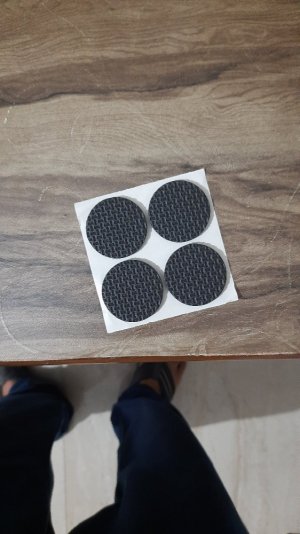

Sir i installed these rubber pads on avr on its legs there is hum in beginning only now and goes away maybe tv unit cabinet has issues or amplyfing the sound vallah i am damned there is no sound now
Good. You've isolated the issue. You can then cancel your order for https://amzn.in/d/cV02Meo unless you have a sub and want to use it for that.
