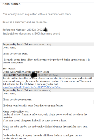

After all this whether you get replacement or directed to service center or just told that it's normal or that they don't hear anything wrong with the AVR depends on the dealer.
You could try contacting Denon, International customer service and make
your case calmly and logically listing what your have tried in a clear logical manner. You may luck out and get an actual technical person or they might just bounce you back to the dealer or service center. If you are going to take this approach prepare to make your case in a clear manner.

the service guy kept telling therre is already noise in background so i feel they are not willing to do anything thats i dont wanna go there it is 70kms and i have health issues as well. if i get surity that he will do something then i can go else futile
