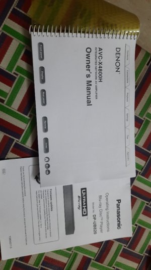

They are doing their best to save planet earth by not including a physical manual, though their price does not justify it. You will have to download from the Denon site. Both Denon and Marantz don't come with a physical manual since many years.
Lol
