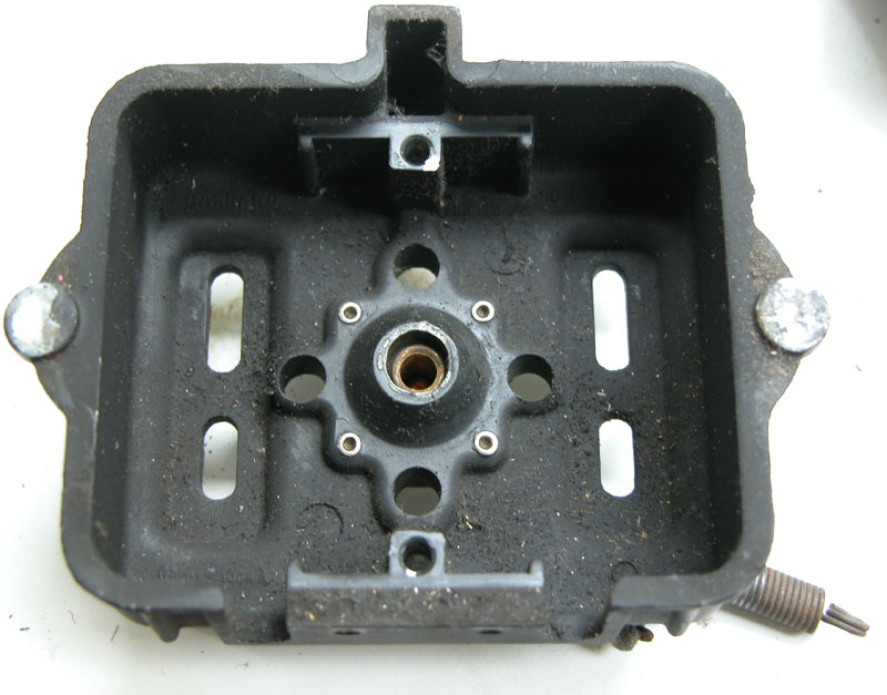

Stevie, seeing this picture a thought just came to my mind. No need to remove rivets. What if we just soak the hardened gunk bush part in dissolving solvent for few hours clean it, repeat it one more time, dry it and lubricate it with fresh oil ?
Unless ofcourse if you want to make the whole thing neat, clean & tidy spankingly new like.

Hiten,
Yes one can do the soak and clean. That's one way. In fact one guy actually put oil and set it on his gas burner on a warmish plate type thingie to warm things up. Motor
