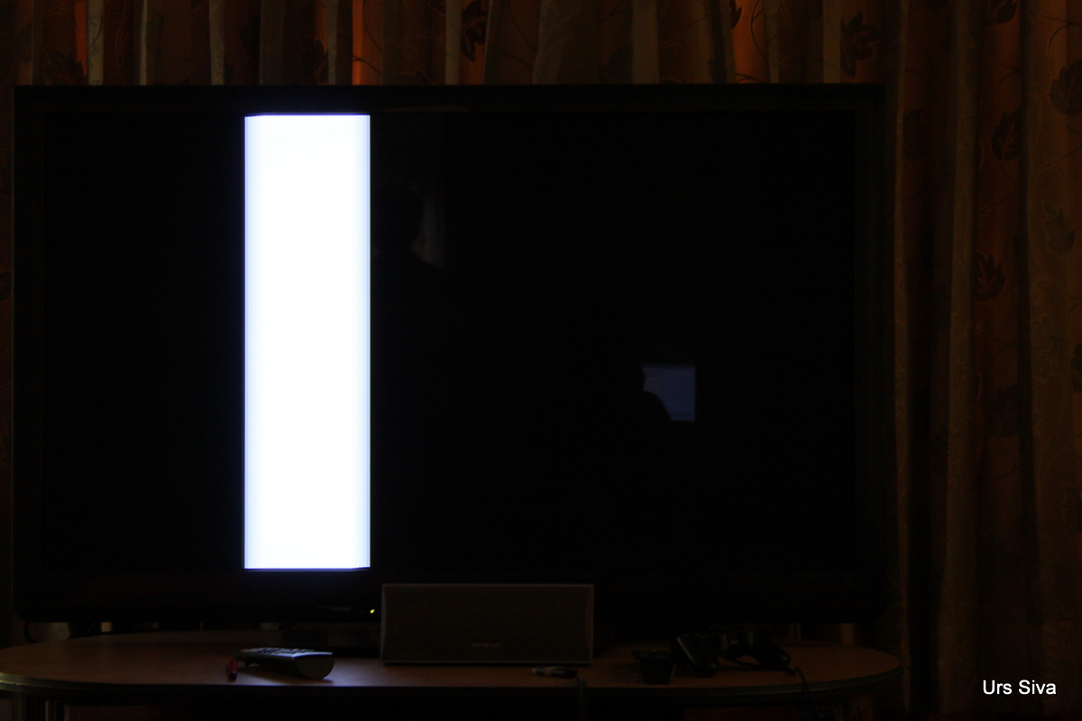

@Blasto , Is it ok to run the Scroll Bar to quicken the break-in time ? Also if its about excitation of all cells equally , why cant we simply display a white image with contrast and brightness at around 30% ?
What is a scrollbar? Does the ST30 have a scrollbar?
You can do that with 100% also. The cells will be always on and age most quickly but they wont be 'excersised' (Meaning it wont change state).
Iam not sure of the difference.
exactly , but instead of increasing the backlight , in panny , the black is changed to grey , without touching other colors or overall intensity of the backlight
I dint see this post earlier.
That is wrong. Are you sure that the other colours are not affected?
Mine increases brightness of all colours including black. Get better shadow details but the blacks suffer which is non negotiable for me. So I dont go beyond 0.
Scrolling bar ..
To remove any image retentions
scrolling bar runs a high contrast bar in loop. why cant it be used for break-in ? I am just curious. BLASTO , also why is everyone going for all gradation colors for break-in , ie aka break-in slides ? If the goal to excite all the cells equally , cant it be done with scrolling bar ?

Scrolling bar ..
It can be used. Only it is not present inthe VT20. I din't know it exisited in the ST30.

I used scrolling on my 51D550 for 150 hours for breaking in. But the scrolling is quite different in samsung and it covers full screen with white and the blacks move.
