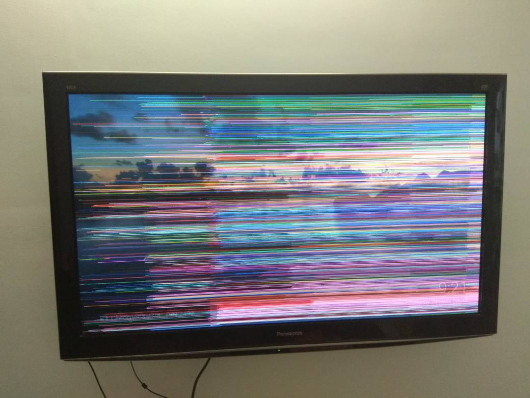

Today my TV fluctuate between this and normal. Also power switching automatically. Any clues?
Sent from my Redmi Note 4 using Tapatalk
