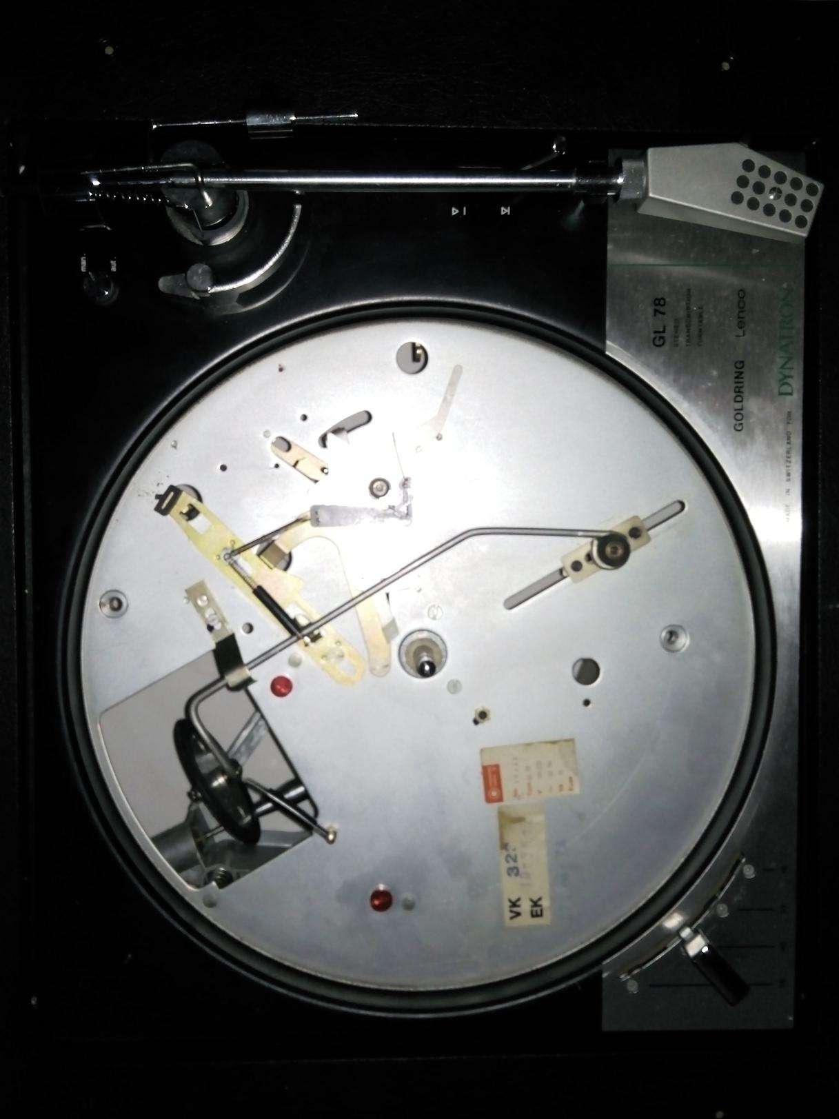

My L-78, arrived last week.
I completed overhaul of main bearing and motor. Oil enriched after cleaning main bearing and motor grease changed with new Lithium based grease. Put new 3-wire mains chord and new RCA cable. Mains earth ground connected to motor chassis screw.
This is my (not so secret) tool to listen motor noise.;)
Pickup of Guitar's tuner connected to guitar amplifier in full volume.
Guitar tuner's pickup attached to motor body without getting in path of idler wheel.
Now motor started, TT rotating platter. With locking nut loose, tuned play of motor armature while its near to tight and minimum axial play and listening minimum noise. Now its freely rotating without any noise, and from guitar amp-speaker I can listen low hum of AC motor at full volume, that's all!.
Now it has broken V-blocks into tonearm. Still played fine with Shure M97xe. now plinth remains for this.
