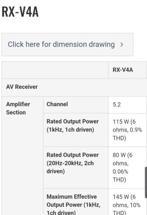

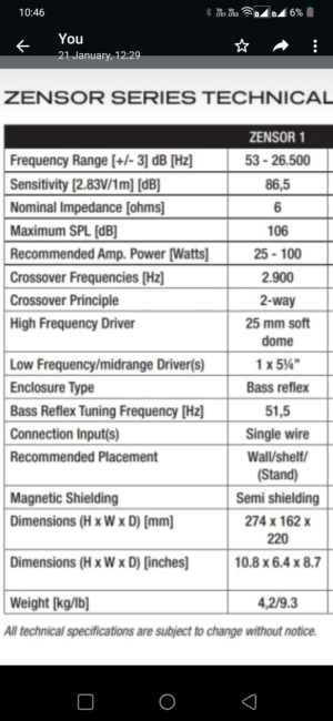

Setup - I am using Dali zensor 1 BS speaker pair as front L/R (only 2 speakers for now). The speakers are being driven by Yamaha RX-V4A (80 Watt per channel in stereo). Setup is in a small bedroom (10.5 feet x 13.5 feet). Listening distance is ~9 feet. AVR is connected with Sony 55X7500H 4K android tv. Content is being played on apps like YouTube, Netflix, Amazon Prime, Hotstar.
Query - I have to upp the AVR volume to between 22.5dB - 30dB for music as well as movies to have good sound level for movies and music. Is this expected from the setup or am I doing something wrong?
I have been using v6A for 2 years. I never had to go higher than -15 DB. Mostly it is set to between -22 and -25 DB. So i think there may be an issue. Could you check if the speaker cables are proper?
No issue as '0' is reference level.
Usually -20 is enough for loud sound. Again it depends on speaker impedance and sensitivity.

Your AVR is fine. I have the same observation as yours. I have set my Yamaha AVR to automatically set the volume at -25dB when I switch on. IIRC some setting known as 'Initial Volume'

Hi, This is expected and I do listen in similar volume range ( -30db to -20db ).Nothing wrong in the setup.
